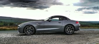

You might not recognise the car :roll: 326s are gone :o & already put some time / effort into "bespoking" it :oops: grills, underbar & wheels :) next up this week new tailpipes & oil change
