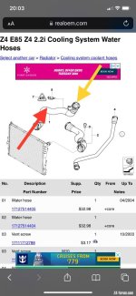

Hi, does anybody know the part number or where I can get a coolant hose, its the hose that sits lower left of radiator from front of vehicle and goes to front of engine (water pump)? It's seeping coolant from the collar. Have included a pic although not great!

I have one
However your issue is more likely to be the o ring failing in the pipe-
https://www.realoem.com/bmw/enUS/showparts?id=BT32-EUR-07-2003-E85-BMW-Z4_25i&diagId=17_0249
Check for part number then ring Sophers BMW for a price. they will want your Vin number to check for right part if you buy from them be sure to ask for Forum discount. They will post items out to you.
Also run the part number trhrough ebay and Autodoc to see their prices.
Good call by enuff check trhe O ring in the hose fitting.
I think the last hose I bought from sopers was under £30 all in including o rings
Are you sure it's not the green o-ring on the temperature sensor that's leaking ? Number 5 on the real.oem diagram. It's very common, mine has been replaced and many others on here. Coolant runs down along the bottom hose and can be misleading as to where it's coming from :thumbsup: 13621433077.jpeg
It could well be you have described the symptoms spot on, I will have a look today, if it is where can I purchase an o ring? Many thanks
