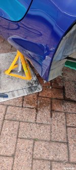

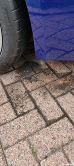

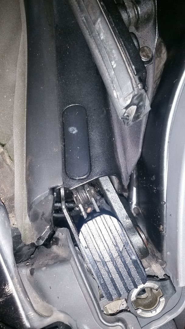

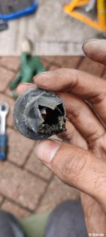

I've had a poke of mine this morning with a fibreglass pole kit. One side was blocked and one wasn't. It's improved as I can now hear it draining under the car and can see it. I'll need to get the wheel off for a proper look
Removed the drain plugs of my MR today (and keeping them off).
I cleaned the pipes from the bottom (was getting stuck half way), and the top with a coat hanger wire, and a stiff bamboo type stick.
Would definitely recommend to clean from top and bottom. The gunk in mine was nearer the top. Just removing the plugs didn't cause the gush of water coming out - that only happened after threading the top wire down.
Was a lot harder to see where I was threading the wire on the passenger side than drivers side, because the roof motor impeded the view. Was recommended to raise the roof by 45° which allowed a clearer view in.
