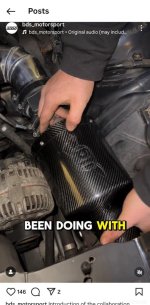

any news on this being avilable to purchase?
I did reply to you on Insta, but for the benefit of this who don't follow me on there, (well why don't you :poke: :D ) I'll answer on here too...
I'm now making Prototype V3 as I wasn't quite happy with the size of it. I also have an idea for my air scoop too, but I have to take the front bumper off to fit some parking sensors, so will do those and the air scoop when I can do it.
I can't say on price yet as I need to have the final mould made first. For prototyping I just use sheet ali as its easy to work with and bend etc, but it's not strong enough for more than 1 or 2 parts as it starts to distort and bend.
I spannered myself on my push bike and re-broke/ fractured my scaphoid that has a bolt in it all ready and broke two ribs, so kinda not been able to do much for few weeks.
But I'm on the mend now and starting to do some things again.

So straight on with my airbox with standard scoop, then my scoop and mine made 1.5bhp more and they operator said the fan blows air in @ roughly 45MPH, so extrapolate that out and it's ok, not huge but a small improvement.
So my airbox, with my scoop and the modded exhaust makes........ Drumroll please :guns:
214.9bhp and 253.1 talks with the bonnet open and 213.2 and 249.9 respectively with it shut. He opened the bonnet to allow the car to get as much air into it as possible.
There is bit of hole in the middle and he said that could be due to emissions/ timing/ fueling and he could get that slightly better with a re-map and maybe get another 5ish hp too but at about 4-£500 I don't think it would be really worth the cost.
To make anymore he suggested you would need to go down the cams and lightened flywhee etcl route and again unless you are into track days it's not really worth it.
Video https://imgur.com/cZUT9M0
Now to try and make a MAF sensor pipe for the N52 engines.
Available to buy here https://www.jollyscarbon.co.uk/product-page/carbon-air-box
