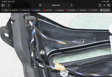

Can you identify these 4 cables? 2 on each side near seat belt mount.

Hi guys, stuck pretty deep within the roof fix atm, but something isn’t right. The rear quarter windows don’t operate..
I’ve had a look back there and I found this, right where the seat belt mounts are. Are these anything to do with the windows or is there supposed to be something else up near where these wires are that they connect to?
Pic is worth a thousand words right..
Right side near where the seat belt retracts into.
Left side where the seat belt retracts into.
This is where they lead to in the boot, just past the rear shock mounts.
I initially thought they might have been from a sub woofer or something like that, but now that looks doubtful?
Any ideas what these are for guys?

That sounds promising.. Not so promising is that they are quite defty wires, so we talking amperage.. I hope they didn't rip there from the hydrolic ram actuators..

Do you have access to TIS or ISTA ..the colour codes on the wires should show what they were if they are factory ..which to me I’m not so sure..
Thanks for the diagram, again appreciated. I do wonder what these are then.. while I was flying to Islamabad , was thinking, is it possible they are from the AMPlifier?
Okay found em… and guess what.. they are the rear quarter window power wires..IMG_1886.png
Blue/red and pinkish/yellow.
Sigh.. a well at least we’ve identified the cables.. this is the right side.

And then I figured it out. They are indeed the rear window power wires.. found the leads hidden inside the window cavity..image.jpg image.jpg pics of the wire and where the rear window is attached to.in the rear wheel well..
