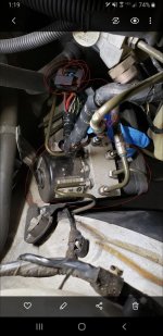

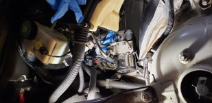

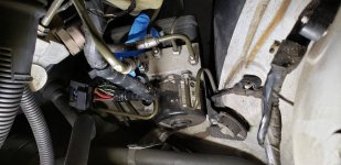

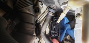

I've definitely checked all relevant fuses, some multiple times. I wish that were the problem. I think you may be onto something with the pressure sensor to the ABS motor. If I could find a pin layout/wire diagram for that specific plug, I could start shooting wires and mayb determine the exact input thats causing the issue.
Does anyone have the pin layout/wire diagram for the DSC/ABS (motor?)

I don't think you stand much of a chance dissecting that connector. It's more than likely the electronics inside the module. You could try somewhere like ECU testing to see if they could diagnose and repair - otherwise it might be a new ABS unit :cry:

Try having a look and explore here https://www.newtis.info/tisv2/a/en/e85-z4-3.0si-roa/wiring-functional-info/chassis-suspension/traction-control-system2/dsc-mk60/
If this is not your model work your way to the first page and select your vehicle from the list and explore that.
Think you need to rule out that DSC pressure sensor in the brake master cylinder, disconnecting it won't prove anything if its already bad, only way I know of testing it is to put a new one in and hope for the best result. Going to be cheaper than a new ABS pump.
It wouldn't surprise me if it acts in conjunction with the brake pedal switch as a back up to it, if its failed maybe stuck in brakes on mode hence the lights staying on, just a guess but worth a go before you go down the pump direction.
