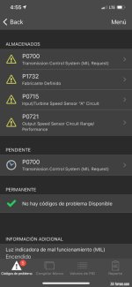

my only and main issue is that the transmission wont drive forward but goes into revers smoothly i got this codes :
P0700 - TRANSMISSION CONTROL SYSTEM (MIL REQUEST)
P1732 - ?
P0715 - INPUT/TURBINE SPEED SENSOR "A" CIRCUIT
P0721 - OUTPUT SPEED SENSOR CIRCUIT RANGE/PERFORMANCE
i think that the main issue are the sensors but since I'm new at the BMW world i want some help in this field.
:!: :!: anyone that had this same problem before that had it fix that can help me out :!: :!:
should i go to my local trany place (I'm almost 90% sure that the will want to replace the transmission) :( or try to do it my self?

update on the issues, i did the transmission reset and clear the codes before turning the car on and it got it out of limp mode.
i drove it for about 3 miles and everything was smooth :driving: until the las mile the car start to hold the gears and the transmission light was back.
i checked the codes again and showed P0733 ( gear 3 incorrect ratio ).
after some research i will try to do the filter, fluid and solenoid change to see if this fix the issue ill keep posting the results.
