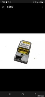

Also need info on the differences in color in connection of the main harness. Mines green but all i come across on ebay is yellow pictures below mine taken apart rn to inspection caps and look for water damage.
