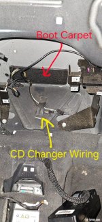

[Ref]srhutch[/ref] has said many times over the years on the forums that UK spec cars come with CD autochanger prep loom as standard fitment.
Here is a picture of a car, with no CD changer, that I broke with all the interior stripped and showing how the CD changer loom is taped down. It should help you find it from the boot as you'll be hunting for it blind:
Usel said:
[Ref]Srhutch[/ref] has said many times over the years on the forums that UK spec cars come with CD autochanger prep loom as standard fitment.
Cheers [ref]Usel[/ref], so this is obviously not subject to the usual Oct 04 cut off for complete looms then, as I know yours was a facelift. :thumbsup:
