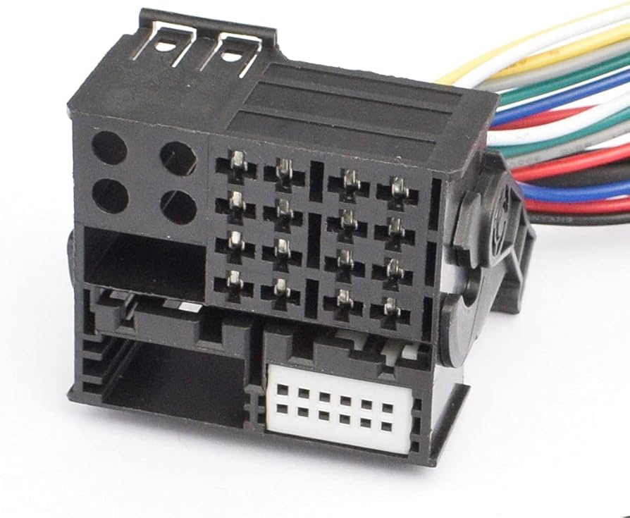

does this mean that if you have the plugs in the trunk - your plug in the radio looks like this?
Meaning, you have the white connector?
Because mine is 100% empty.
(I take left is for AUX, right for CD changer)
Ah yes, I did mention UK spec as that was one of the items standard for the UK. Italian like other European countries don’t have this standard.
The plug at the radio end is then fully wired, especially if you have aux as well.
So this definitely closes the discussion on my missing cables ;)
