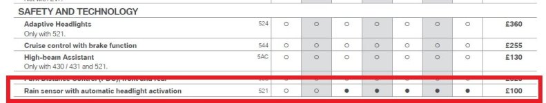

Right to clear it all up....
If you have Auto Wipers then you also have Auto Lights.
Auto Lights switch...
Normal light switch...
If you don't have one, then you don't have the other.
If the lens you mention is on the top of the mirror frame then it's for Auto Dimming interior mirror only.
The sensor for Auto Wipers/Auto Lights can be found on the windscreen...
Hope that helps

tintoverano said:
I don't have auto-lights, but have auto-wipers
Well that's odd as they are controlled from the same unit (the sensor on the wondscreen).
Does mean that you can have auto lights for the cost of a switch and a bit of coding :D :thumbsup:
In fact the switch may have been changed by a previous owner!!
I got the info from the official price list. There are no single options and it was standard on everything except the 23i in 2011, so I can't see any other years being different as the systems for both parts are from the same unit.
