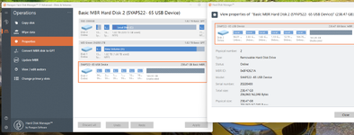

Here is the CIC computer which powers the idrive screen and system.
Used for the E89 for it whole run and first released in 2008..its a product of the very early 21st century..
Still useful as its plugged into many sub systems on the E89 and with a MMI box does a great CarPlay rendition.
The map data and the cd track info and possibly some stored audio resides on a 80gb ruggedised hard drive similar to an old laptop drive.
It’s held in a cradle and can be easier swapped out.
There are a number of failure modes on these units, one is the failure of this drive.
A geeky dodge is to clone the contents of the drive before it fails and transfer it to a solid state drive..
Apart from better reliability the SSD has much much faster I/O…over 10 times faster at 50m/bytes per sec
So…your menus won’t operate faster but any map function will be a lot quicker…

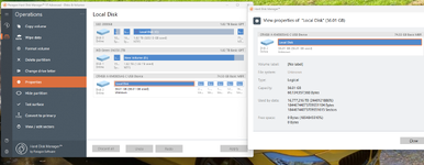

There's a chicken and egg issue..you have to copy the image of the hard drive BEFORE it fails..then its too late.
The drive was formatted and used in a Unix system (QNX) that idrive on E89/90 uses.
So any normal PC file utilility will fail.
As you can see there's not that much actually stored on the drive.
Pointless storing audio as its crap quality!
You need a whole image file manager and an adapter cable to be able to read the old hard drive and then write that to a USB stick..then read the USB stick to write to the new SSD.
Fof those who asked the old hard drive is held to its carrier with just 4 small screws..remove them and fit the now copied SSD and you are good to go!
