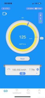

Several folks have asked following the bigger turbos and tunes 'well how fast does it go?'
There are 3 issues with performance testing the car..
1) Where I live there is no access to a long, flat, open wide fast road to do any performance testing..this invalidates using a GPS data logger such as Dragy to come up with some standard figures as gradients impact the numbers.
2) The 0-60 is pretty brutal on the powertrain..somewhere north of 600 bhp there's a real danger of snapping drive axles and a bit further damage to the DCT box on full on drag starts.
3) Calculations show that with the curret gearing, how the engine revs out and now holds peak power that the car given room should do between 190 and 200 mph..but that needs a lot of room.
I'm contemplating next year doing some high speed runs at Elvington.
However to paraphrase .since I'm not a Stig..we do have the Stig's Italian cousin.
I have a friend with a Yellow 35is in Rome..he's going down the same broad route..
Same CSRF down pipess, TTE500 turbos, Wagner EVO3 FMIC, tuner, similar turbo inlets,outlets, charge pipe and DCIS vs Mr.5 airbox mod..he doesn't have a LSD or big bore exhaust.
Engines tunes are very close.
He's now done some initial Dragy 100 kmph to 200 kmph acceleration figures (62 mph -125 mph)
And its pretty consistent around 7.78 seconds..
If you correlate the findings its pretty much linearly related to real BHP that any car produces..aerodynamic drag and subtleties don't really start to play that much in that time, distance and speed.
