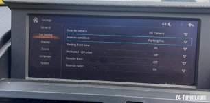

AnubisZed, mine switches over to parking sensor screen when I shift into reverse, but when I shift back into drive to go forward, Apple CarPlay comes back immediately and I lose the parking screen. Is there a way to make it stay on parking screen for a while? That would be the only negative with this system and it's a pretty small one.

There’s an option in the mr12volt settings, something along the lines of “with gear selector” I can’t remember exactly but I had the same problem but that sorted it out.

Thanks, I think I saw that, but "with gear lever", the most intuitive option, was already selected. I'll have another look and try the option "CAN bus" - maybe that's it

Just checked mine and you need to select “parking key”
Thanks for sharing, but it didn’t work for me.
Mine is currently on “CAN Bus active” and as I said that switches to Parking sensors when your shift into reverse, but it exits the instant you leave Reverse gear.
I tried “Park key active” and “12 volt” but they did nothing at all and it wouldn’t even switch to parking sensors pressing the parking sensors button or shifting into reverse.
Whilst I was checking mine I tried alternating some of the settings and noticed that when I re set them back the Parking sensors wouldn’t stay on when I shifted out of reverse, but once I’d turned the car off and removed the key and re started the parking sensors stayed on when i then put it in drive, so perhaps it needs to shut down to apply the settings.

Nope,,, didn’t work for me unfortunately.
I changed the setting, took the key out and even left the car overnight.
No change unfortunately, no parking sensor screen at all with “P key active” setting..
Maybe it’s the firmware version?

Where did you buy your mmi box from? That firmware/software is not original from Mr12volt, so I'd assume it from another supplier?

Aha…problem at least partially solved..trouble shooting a Mr 12 Volt box that isn’t a Mr 12 Volt box… :tumbleweed: :rofl: :headbang:
Yeah mine was from ztuzauto… but I think they’re all just copies of each other, based on the same android OS, the same hardware, and the same software… perhaps with a subtle difference —the parking sensor settings work differently 😂

Not necessarily true…whereas the hardware and software is often cut from a main source tree there are in fact a myriad of tweaks that can/ do happen…if you read the thread on E90/E89 android head units you would be amazed at the number of dialectal versions..plus rapid iteration of s/w with no concept of backward compatibility means even the same h/w with different firmware levels can be markedly different…the Mr 12 Volt s/w has gone through at least 20 releases covering at least 4 h/w versions ..so unless both of you are on the same release of the same h/w by a specfic supplier there’s no guarantee…fwiw

Hmmm, OK, well firstly I'd say, on the most part, they are all relatively the same, they share the general same design, firmware and software with some tweaks between specific sellers that sell them as their own so may have some different settings etc.
Now the Mr12volt box design, firmware and software are not shared with anyone else, so the fact that this UI looks the same in layout is a huge coincidence.
OK, so my settings are "Aftermarket Camera" and "Parking Key" for activation, this is because I have a manual, and for an automatic it would require "Gear Position" to activate the reverse camera screen.
