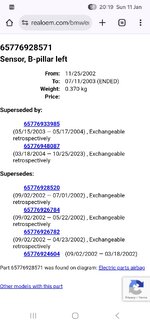

Should it be the left side module, you need the serial or part number off the module as they simply cannot be swapped. You need a compatible one and then that would need coding to the car.
Post a picture of the numbers off the module.

Id consider yourself very fortunate. You by sheer fluke bought yourself some time to get it resolved. If you can get pics of your modules we can get a list of suitable compatible replacements to keep an eye out for.
