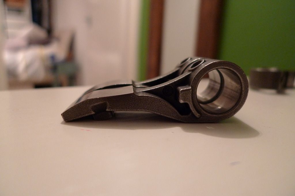

What's the latest theory behind why we sometimes seem excessive rocker arm wear? Is it related to valve clearance adjustments in any way or is it just a matter of occasional case hardening failure (due to oil starvation?) followed by rapid degradation of the surface?
I've still got the followers that came off my car when it had a rebuild. The wear will shock you - measurable in millimetres, not 0.01s! :o
bad material batch from the factory maybe?? ran for a considerable time out of spec maybe?? i guess as with all things, things just go wrong for no other reason than the law of averages.

Beedub said:
Along with possible material defects & law of averages Id wager thrashing from cold , thrashing while hot ( trackdays ) & both coupled with poor level of maintenance in regards duration , spec & who carried it out :wink:

On the bad rocker wear subject....
Overtight and loose clearances could cause a problem if left for a long period of time.....But if the service schedule is kept (with clearance checks)and the problem still occurs,then i would guess that the CPV is leaking oil back out of the head into the main oil gallery..
The CPV isnt a common failure point,but neither are the cam followers wearing..
I dont have any real evidence that there is any direct relation,there isnt enough of the failures that you can get your hands on as an individual..
But its a cheap enough thing to replace,so worth swapping out..

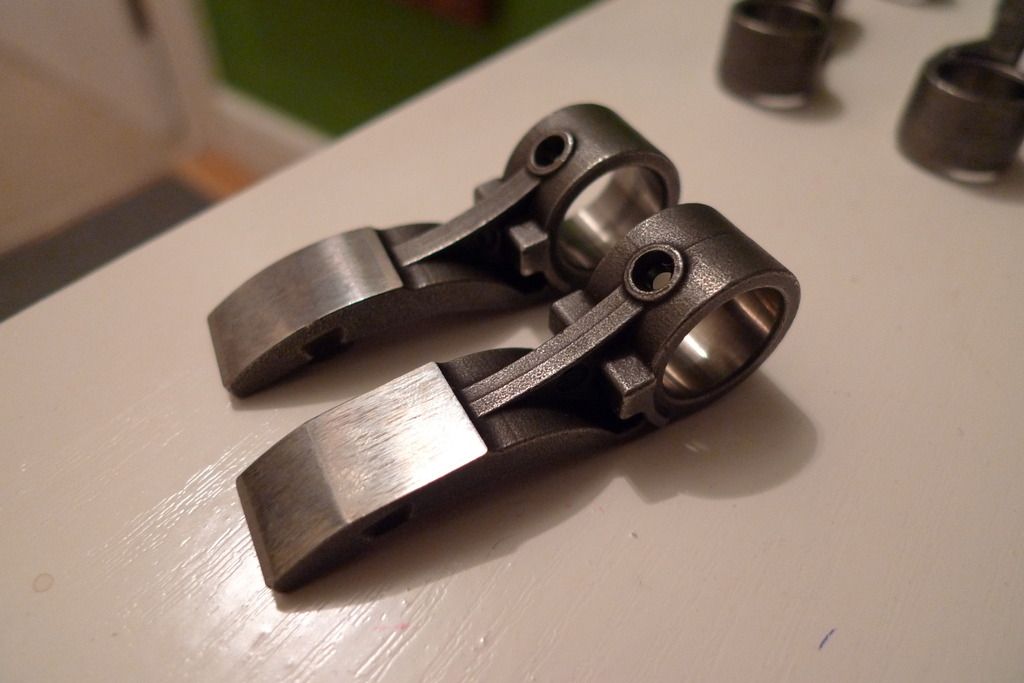

MrPT said:
Here are the best and worst of them, side by side:
Holy crap its worn flat nearly :o :o whats where is you can see a clear Crease where the wear finishes and starts again...
those fingers are incredibly hard material as with the cam lobes, surely thats got to be a material defect on the cam or the rocker.
