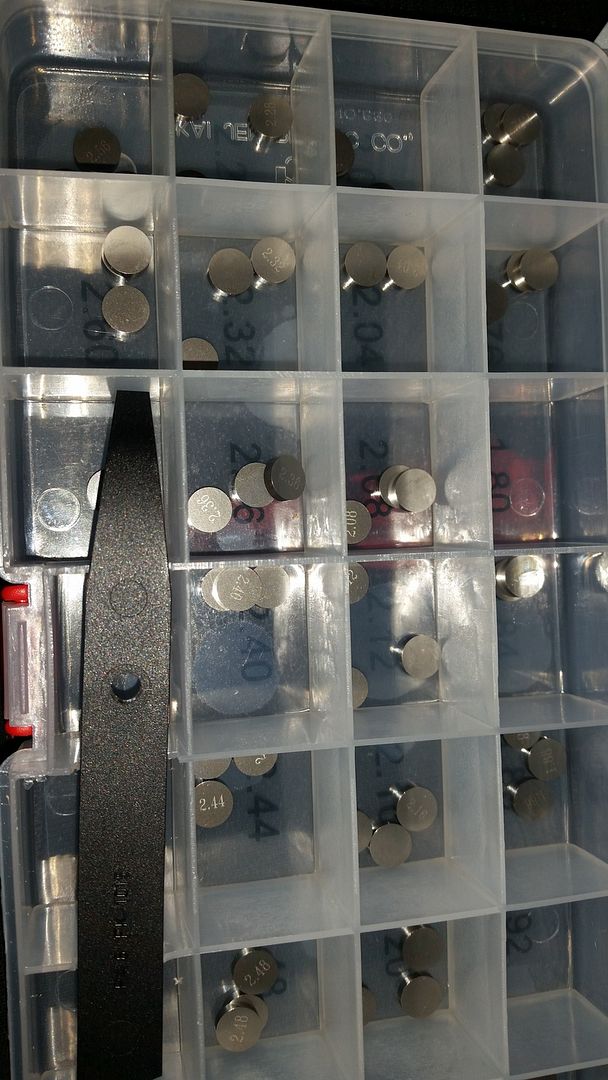

from all the research I'm going the inlets tend to tighten, the exhaust tends to loosen, which is exactly what yours is doing, inline with most I've come across anyway, including my z4.
also the shims go up in .04 so both could have been brought into tolerance. note the numbers at the bottom on the box... so he's either saying that to put you off the scent or lack of knowledge could be the issue as his response doesnt make sense, he's based what he said on the shims being 0.05 :headbang: :headbang: :headbang: :headbang:
you not going to burn the exhaust valve bringing it inside the tolerance spec... :tumbleweed: :tumbleweed:
so basically that inlet will get tighter and that exhaust will get looser from where they are now.
His answer doesnt make sense, no-ones called into question the car being stone cold doing these. With how they currently stand id be getting those 2 changed personally , this guys response is imo kinda worrying btw.

and don't forget the looser one on the exhaust side will start banging the valve seat if that continues to loosen , too tight which can lead to the valve being held open both in the extremes BTW you no-where near that but all it takes is a year of accelerated wear, why wait, just get them in spec don't forget this guy was ALREADY in their as part of a paid for inspection2 and he could have just done this to the tolerance, my concern isn't so much for the car right now as currently its not going to hurt anything and OP can get these in spec easily, but this "master" tech thats left them where they are... even more concerning he's quoting incorrect info....
Don't forget people the next Valve clearance on this car could be 4 years away if you run to the schedule.... no way should those be left like that or if they are, they need checking again in 12 months time. Personally id want them in spec, especially after my recent experience which iS very likely the same type of decision that simpson probably made initially which eventually led to a zero clearance, i can't challenge in retrospect because i didn't get a shim report, shim reports are imperative as they allow THIS type of dialogue if needed...
Hell we may be splitting hairs over 0.01 but lets not forget the difference of the bottom to top end tolerance itself is only 0.05m, the window is tiny, so that 0.01 is still important imo ( if only to allow that tiny bit more wear before the next VC check) .. out of tolerance is out of tolerance and we are already dealing with a tiny range, they need to be in spec. Just trying to save people the hassle i had to go through potentially it was very stressful and in the end i had to research for weeks and jump into it myself and buy some expensive bits as part of that process.
