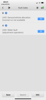

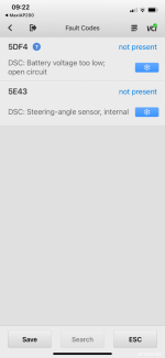

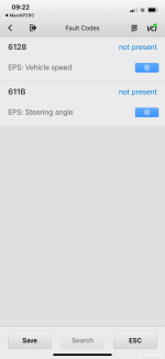

Looks like you might be on to something with the steering angle sensor...
