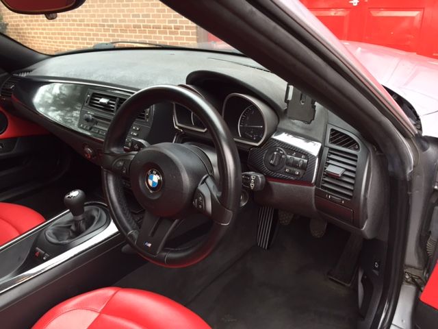

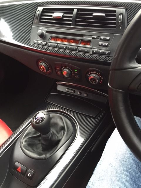

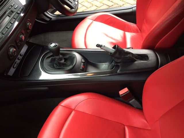

Hi Guys,
So spent a few hours last night carbon wrapping my spare interior trim and fitting my new handbrake and gear gaiters with my new ZHP gear knob.
What do people think?
