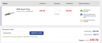

I serviced the car today, and decided to change the spark plugs based on advice I've read for tuned N54 engines.
As a rule of thumb, spark plugs should go 1 step cooler for each 100bhp gained.
The NGK 5992 / ILZKBR7A-8G are 1 step cooler than the OEM Bosch ZGR6STE2. But you need to gap them to 0.022" or 0.56mm. They are supplied at 0.8mm.
A secondary advantage is they have an Iridium coated centre electrode, not Copper like the Bosch plugs.
Iridium > Copper.
On offer at ECP at the moment.

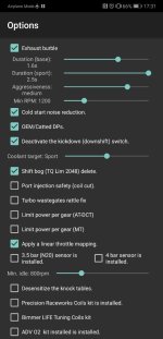

OP, in your screen shot you have OEM/Catted DP's checked. Shouldn't that be unchecked as you have after market downpipes?
