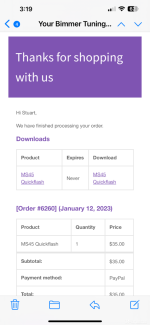

However I downloaded MS45 quick flash from bimmertools
Don’t expect any product support mind you
It worked when we figured out what we were doing on martins car and several afterwards

I am no software expert and simply watched Stuart but the background to my issue was as follows:
DME died so car would start but hunt and not respond to the throttle.
Got another compatible DME and fitted it.
Wouldn't work as the EWS didn't recognise it.
Stuart got this fancy software and to put it in my very simplistic terms, downloaded a couple of files from the new DME.
Before reinstalling them ticked a box 'EWS Patch' which removed the link to the EWS.
Reinstalled the files.
Car starts and runs perfectly.
So I'm thinking that in your case all you need to do is remove that link to the EWS. Then the DME won't bother to ask anyone's permission, it will simply run the engine.
