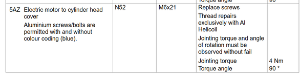

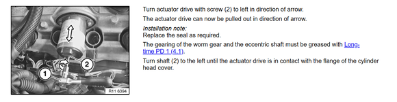

Just one thing, how do you reset the valvetronic motor?
There's a sequence involving the accelerator pedal - I forget, easy to search up. But, more importantly, make sure you've watched how to remove the Valvetronic motor to make sure it fits back properly and to avoid breaking it on the way out. The last M539 Restorations video covered it really nicely (38min 45sec in):
NewTIS makes no mention of any recalibration etc, and I've only ever done what these instructions say.
Before you put the top cover back on, switch the ignition on and you will hear the motor do a quick movement to settle itself.
