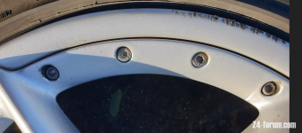

You have to split the rims to repaint them otherwise it is a waste of time. The bolts are titanium and the head of the bolt can strip. If they come out fine but if not the head of the bolt has to be drilled off carefully. This is a terrible example of a bodge job. Two of the original bolts have had their heads stripped and two wrong bolts have been fitted .

Any idea if the original bolts can be ordered somewhere?

Yes but they are expensive. Many people just reuse the existing ones.
I have a handful of original bolts if you need.
