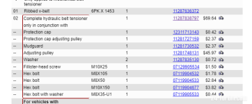

If you are replacing the tensioner (M54 i presume?) too, then sourcing an old design oem spring tensioner may prove hard. That was superseded by a hydraulic tensioner, oem made by INA and, comparing them side by side, the old design is flimpy compared to the new one. INA has a nice retrofit kit for the conversion.

The hydraulic tensioner design (INA 11287838797) was introduced due noise issues with the old one. The design should give a more constant pull on the belt.
