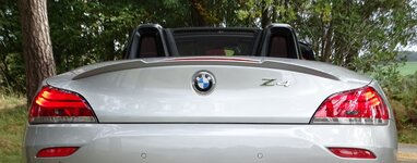

FWIW, I've now had 4 of these Chinese specials on previous & current E89. They need painted/colour coded to the car or black if that's your thing. 3M tape application easy peasy. They have a lowered section in the middle so as not to interfere with efficiency of third brake light on boot. Try this link. https://www.ebay.co.uk/itm/264516561107 I paid £80. Decent paint job by a paint shop anywhere from £50 - £100. Although the delivery lead time pushes out to over a month, I was pleasantly surprised when mine arrived in under two weeks. Rear spoiler.JPG

Stuart are these easy to fit? I've just ordered one for the G29 (I know I said I wouldn't have one on the car :rolleyes:).
Easy. Get the spoiler into position and mark it out with masking tape. Then remove the 3M tape and set it back down in position and firmly press it down by hand. Suggest in this cold weather, you perhaps heat the boot area where it's going to sit with a hairdryer or the likes as it'll stick better.
