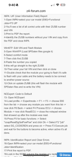

Any way you'd be willing to jump on a screen share with me and guide me? I thought for sure I had followed that process correctly. Issue im running into is a lot of my programs have different inputs. So ive had to kinda rely on chatgpt interpretation and old forum posts ive dug up from 10-20 years ago.
For refrence all the tools im using either came with my d+kcan cable or i downloaded off easy mikes bmw tools.

I’ll send you my step by step guide that may help
Pm me your email

bigwinn wrote: Sun Jun 29, 2025 10:02 pm I’ll send you my step by step guide that may help
Pm me your email
Hey so I followed that guide correctly I believe. After clearing i have now 4 codes in inpa
93E4
93AC error count 2 (this one was there before with only 1)
93E6
2 are seatbelt codes which I don't get where they came from because I never touched them and the other is still the same issue of non-start of system time. (Going purely off chatgpt translate) Ediabas started the time correctly. What am I doing wrong?
