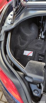

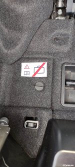

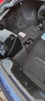

JakeS76 wrote: Tue Feb 27, 2024 9:45 pm Thanks, are there any issues with removing the battery to charge it? As I have to keep my car on the road or a car park
Correct, prevent the boot lid from getting closed before removing the battery. There are 2 flippers in the lid which should be pressed to block the lid before laying it down. This way no blanket or anything els is required to keep the boot accessible.

- Posts: 184
- Joined: Tue Feb 20, 2024 1:10 pm
What is it really useful to know as a new e89 owner?
Thanks for the warnings on the boot lid.. Any chance of a photo of the flippers that you need to flip?
=> My already linked maintenance thread.JakeS76 wrote: Wed Feb 28, 2024 11:52 am Any chance of a photo of the flippers that you need to flip?
IMHO not on the VARTA's, only on the OEM's.
Important is, that it got replaced in between. So I wouldn't care about it at the moment.
