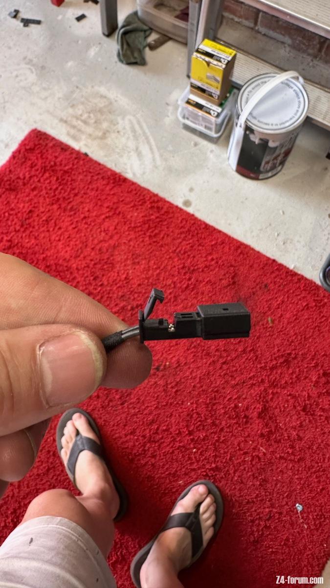

Following code 00A698, I ordered new hall sensors from BMW. The E88 units at £15 each. Also bought new pins. Then measured the old cable, and cut to size. Popped out the old pins from the connector and all good.
However a word of warning for others. Take note of how the cable runs and where you cable tie. After my first test all was ok. Then went for a drive to find the rear hatch came up and continued to try moving up and nothing else.
Took it all to bits to find the rear most (shortest connection) had mangled itself as the piston moves back through the hinge bracket. Due to this the module could not tell the boot lid was fully open and tried to continue to open it.
A new connector later and secured correctly all sorted. In total 45 minute job with a cuppa ☕️ 😎👍
