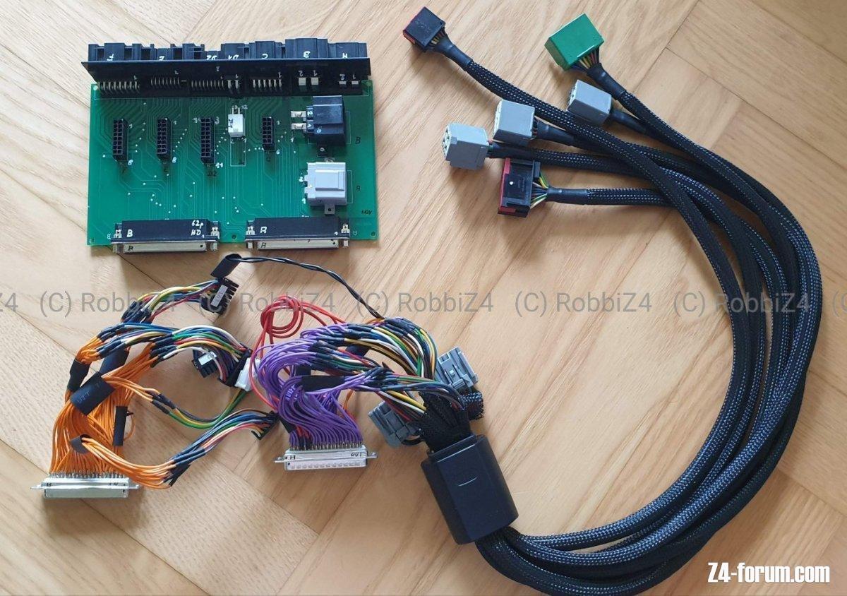

The Y4 diagnostic system got finished in between. But in fact it's for a completely different world. :rofl:
VOLVO C70-II with a retractable hardtop
An additional concentrator K7 has been finished and tested:
Y4 K7: VOLVO C70-II with a retractable hardtop
Y4 CRM cable adapter
Reworked/extended to my needs with 2x 78 pin plugs for signal export
https://www.zroadster.com/forum/threads ... st-3704715
Y4 Concentrator K7
To collect all signals of the CRM and to provide 4 different signal configurations for the 24 AD converters, which result in 4 different roof EKG charts.
https://www.zroadster.com/forum/threads ... st-3706334
There is a mods4cars roof module integrated to always support roof opening/closing by key while having my system attached to the car.
:thumbsup:
This roof is "a bit" more complex than the one in our Z4 E89: 11 hydraulic rams instead of 6
Have a look at it's kinematik:
:ant:
