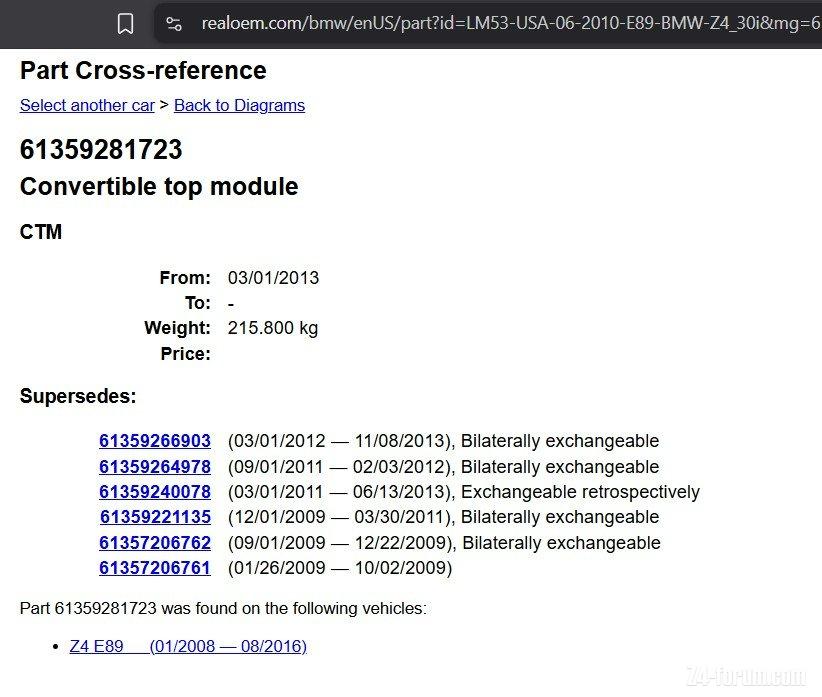

I saw this compatibility chart, and it makes it look like the newer CTMs have superseded the older ones (You can uses newer 4 solenoid CTM with a 3 solenoid hydraulic pump?).
I can buy a 61357206761(SW 4.7), or 61357206762(SW 5.0) (Older version) For $500
Or a 613509281723 (2013 "newer" version) for $265
Is the compatibility chart I posted incorrect? Should I get the CTM with SW 5.0?
From my research I understand that I need a CTM made before 03/2012 to match my 3 solenoid hydraulic pump vs the newer 4 solenoid hydraulic pump. RobbieZ4 mentioned SW Version 6.0 being the newest CTM that the 3 solenoid hydraulic pump would accept. The newer CTMs are all SW 6.7.

No and maybe yes.Rob E89 wrote: Tue Jul 01, 2025 8:34 am Im going to buy a new CTM. The CTM on the car is : 61357206761 dated at 15th week of 2009 with SW version 4.7
RobbiZ4 mentioned SW Version 6.0 being the newest CTM that the 3 solenoid hydraulic pump would accept. The newer CTMs are all SW 6.7.
As written, this is the only correct info.RobbiZ4 wrote: Wed Jun 18, 2025 8:26 pm ...one built with a SW version up to 6.00.00 (latest version for 3 solenoids), one with the newer one up to 6.70.00 (latest version for 4 solenoids).
Your compatibility list is hardware based, but doesn't contain the different sw requirements. New CTM's from stock always expect 4 solenoids and have to be downgraded with ISTA/P for 3-solenoid-pumps (or require a dummy resistor as solenoid replacement on the green CTM plug).

I have ISTA+ 4.32.15, Is it worth saving $250 buying the newer CTM and downgrading the SW to 6.0 or earlier, or should I buy the SW 5.0 CTM to save a headache. I notice the HW(hardware?) version changes from 2.0 to 3.0 on the newer ctm too.RobbiZ4 wrote: Tue Jul 01, 2025 2:19 pm

ISTA/P is required for programming, another TB consuming prog.
The newer hardware contains the additional port for the 4th solenoid. Interestingly there are hw-3.0 (4 solenoids) versions with sw-6.0 (3 solenoids) available as well.
Might be easier to think about the dummy option in combination with a new CTM from stock:
1 resistor
2 short wires to place it next to the green plug
2 MQS female contacts
shrink tube
1 resistor
shrink tube
