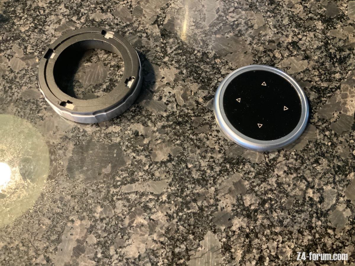

I thought I’d put these items as they may prove useful to others…
So I’ve been irritated by the bezel surrounding the iDrive controller knob…for some reason the bezel had partially separated with a sharp edge that would snag your finger / finger nail if you placed it in the wrong position whilst operating the rotary knob.
A bit of research showed that there had been 8 iterations of the controller..all seemingly compatible with each other.
So when I took the interior apart and was forced to take the controller out of the trim it seemed the perfect time to do something about it.
My first port of call was one of the many Chinese knobs the clips over the existing knob and replaces the central inset cover of the know with a wider cover to match the wider slip over part.
On examination it seemed rather tacky..albeit cheap..so I looked at trying to either replacing the whole controller or try and repair the damaged bezel.

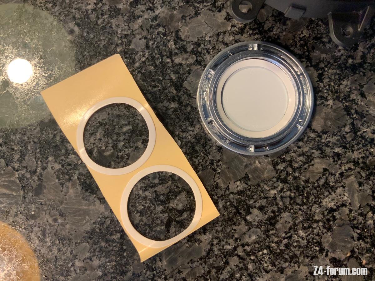

So I bought the bezel as a separate item..around £50…
However when I got it I just couldn’t see how to fit it..so looked at buying a brand new controller..the latest version being over £400….
A Google revealed an E90 forum guy and then a US Z4 forum guy who had tackled this..you just need to use a small flat bladed screwdriver to push the 4 black plastic tangs either side of the knob near its base which are obvious if the controller is out of the trim.
So out it pinged..after trying to fit the new bezel 180 out it then fitted like a charm..at a stroke elevating my tactile experience to a new level.
So I won’t bother with a new controller…the only obvious benefit is that the switch labelled CD is renamed Media..
Summary..
All Z4 E89 controllers are interchangeable
The E89 variant is unique as the base is slightly wider so not interchangeable with E90 or other CIC systems
The bezel is an aluminium wrapped plastic item, in my case the aluminium part had delaminated from the structural plastic body
If you are OCD you can swap the bezel out and…you can use a permanent marker to remove any white plastic wear through marks

Well, a very good description.
We just had a successfully replacement of a dead E89 iDrive controller with a used non-E89 partno 65829240956: https://www.zroadster.com/forum/threads ... st-3511280B21 wrote: Sat Feb 11, 2023 3:30 pm The E89 variant is unique as the base is slightly wider so not interchangeable with E90 or other CIC systems

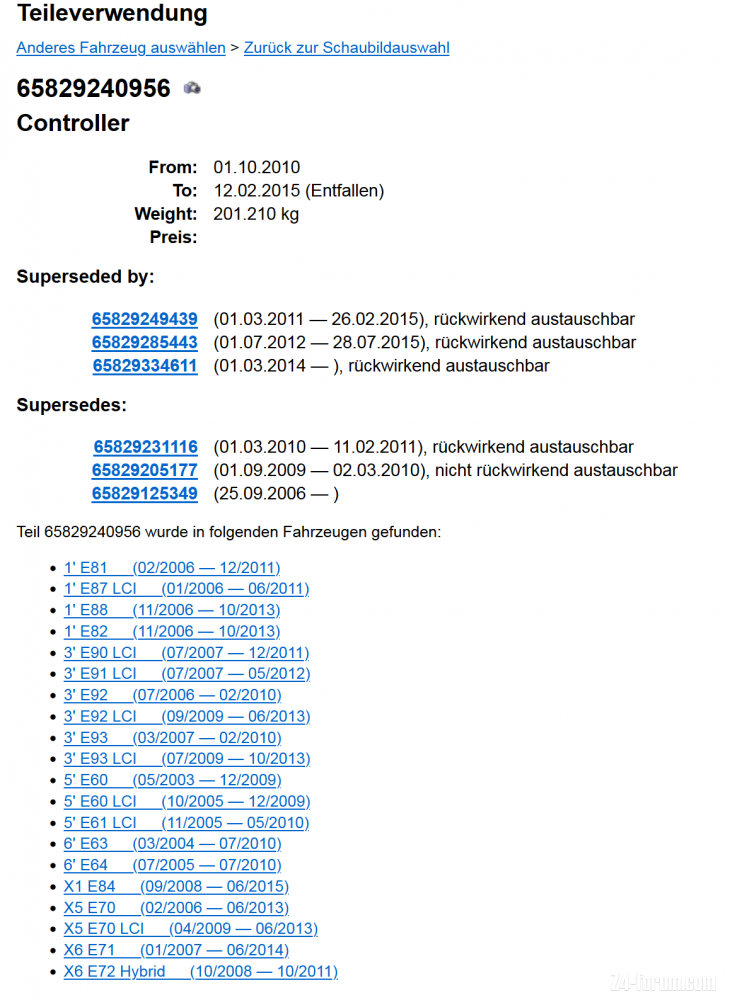

Interesting Robbie..I see its listed in Real OEM as NOT fitting the E89..could you ascertain why you fitted it but BMW said you could not?
s/w or h/w?
s/w or h/w?

This can be answered only by BMW.B21 wrote: Sat Feb 11, 2023 6:16 pm Interesting Robbie..I see its listed in Real OEM as NOT fitting the E89..could you ascertain why you fitted it but BMW said you could not?
s/w or h/w?
I know the guy personally, who replaced the controller with this "non-fitting" part.
As a dentist, he is used to taking care of even the smallest inaccuracies.
But indeed there is a difference in the design of the knob, you can see on the following pictures of my E89 and E61 controllers in the named thread.
https://www-zroadster-com.translate.goo ... r_pto=wapp
That seems to be the only difference, not mechanically or electrically ones.

Any controller from the 3 series (E9x) will work in the E89. The reason it says it won't work with in the E89 is quite simple....B21 wrote: Sat Feb 11, 2023 6:16 pm Interesting Robbie..I see its listed in Real OEM as NOT fitting the E89..could you ascertain why you fitted it but BMW said you could not?
s/w or h/w?
The controller for the E9x has a specific surround bezel on the actual controller that is completely different to that used on the E89. BMW list it as the specific version for the model it came from. But you can remove the surround bezel from the E9x and fit the specific version for the E89 and hey-presto it works perfectly.
There is one proviso though, and that is a visual one. On most of the earlier ones the top left button says "CD" whereas most of the later cars had "MEDIA" written on them. Other than that they are the same.
