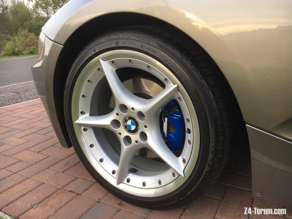

Post by Mr_Ke1th » Wed Sep 23, 2020 7:51 pm
Painted callipers..,..
2005 E85 3.0

Post by Z4C_er » Thu Sep 24, 2020 8:40 am
Mr_Ke1th wrote: Wed Sep 23, 2020 7:51 pm Painted callipers..,..
Lovely. Been going to do this for a long old time.
Was interested to see in a video yesterday that if you replace the slide bushings with brass sleeves, then you don't need the outer (silver) clips anymore. My car's going to Ross next week for a brake fluid flush, so I might tackle this project after that.

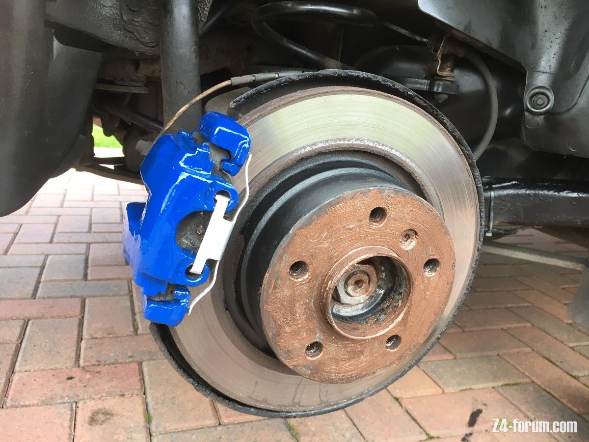

Post by mgrlane » Thu Sep 24, 2020 9:56 am
Z4C_er wrote: Thu Sep 24, 2020 9:36 am
OK, on this page it included a how-to video that I watched and in the video he states you don't need the clips anymore.
https://www.bimmerworld.com/BimmerWorld ... ipers.html
[/quote]
I like them but I don't think they are for me. I would want the holes that the clips fit into filled in and painted off (if that makes sense).
Here is one of mine in rosso corsa- bit bright right now :o but I am sure it will calm down when it gets a coat of dust on it. :D

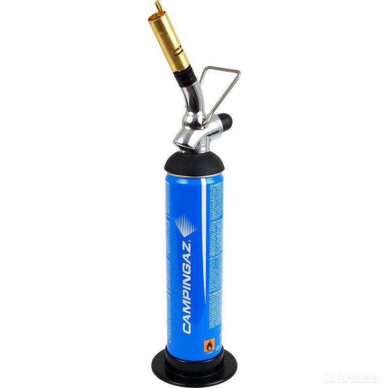

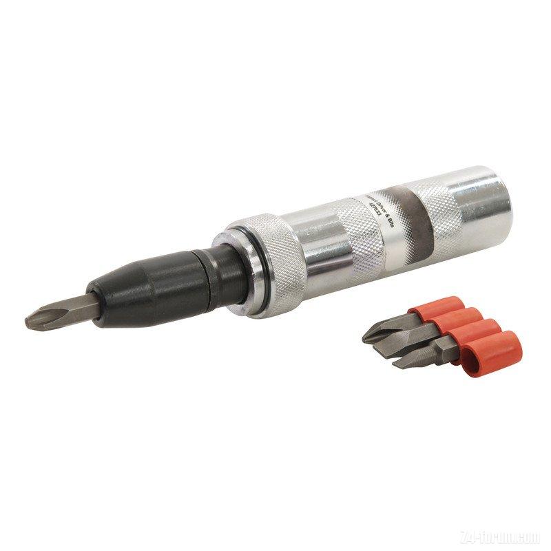

Post by patriot66 » Thu Sep 24, 2020 7:08 pm
bigwinn wrote: Thu Sep 24, 2020 5:39 pm Busy day today
New wishbones and lollipop bushes
Arb bushes
New discs and pads
Thanks to PDJ for being on call to tell me to hit it harder when a ball joint got stuck! :headbang:
Only thing that failed was one of the disc retaining screws got stuck- back to that tomorrow to drill the b’stard out
Looking at the bushes that came off, especially the lollipops, they were a bit flaky- deffo expecting a change in handling
Wow ! A very busy day there Stuart :o
Has the disc retaining screw rounded-out ? If it's still intact then the following couple of tools will usually do the trick :thumbsup:

Tried the impact driver- no dice
Think tomorrow I’m going to try to drill it out- then get some mole grips on the stem once off

The trouble with the disc retaining screw is it protrudes through the back of the hub flange and corrodes from the back. A blow torch usually breaks the bond. Smother the new screw in Copperslip :thumbsup:
