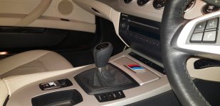

Well Since no one could provide a definitive answer I bit the bullet and got my self a ZHP gear-knob straight from BMW........
IT FITS!
I have attached a couple of pics as evidence. I mean to take more but in the end, what I thought would be a lengthy process of fettling and swearing literally took less than one minute. I did learn some things along the way though so hopefully this will help others in their quest for weighty knobs!
1) Removing the old knob was (for me) very easy. Simply unclip the lower boot frame, grab knob, pull...... pop!
2) The boot and knob are joined together but are not 'one piece' as has been sighted as a reason for the ZHP knob not fitting on an E89. The boot is in fact clipped to the bottom of the standard knob. Inside the boot is a plastic piece which is the same shape as the bottom of the standard knob, the knob has 3 prongs that clip through this to attach the boot to the knob. I gently inserted a flat bladed screwdriver between the boot and the metal ring at the base of the knob and then slowly twisted. This easily separated the boot and the old knob without damaging either. The only side effect of this, as can be seen in the pictures is that the shape of the plastic piece inside the boot is not the same shape as the base of the ZHP knob so it sticks out a tiny bit. I will alter this at some point but this will do for now! As it is I have not joined the boot to the bottom of the ZHP knob in any way, I have to have a think about the best way to do this before I make a decision. I had limited time this evening so really just wanted to see if the knob would fit.
3) The ZHP knob is a BEAST. Having never seen one in the flesh I now think the pictures make it look smaller than it really is. It is about the same height as the standard knob but much more chunky. I love how it feels, much more robust and classy, and being rid of the plasticy feeling of the old knob is very nice!
4) It does not perform some miraculous alteration of how the shift feels...... Does it feel nicer? Sure..... Is it a night and day difference? Not really, it's just a nice weighty gear knob that looks great and feels great!
So there you go, a definitive answer. From a mechanical perspective the ZHP knob does fit on an E89, and does so perfectly. By that I mean the contact points between the shift shaft and the knob, including the guide notch in the shaft and it's counterpart in the knob match exactly. Once on it sits perfectly with no movement, rattles, twisting etc etc. You will have to either alter the boot ever so slightly (due to the shape of the plastic piece that the old knob clips to) or simply live with it and perhaps use a very small amount of glue to hold it snug against the bottom of the ZHP knob.

Thanks for posting. I followed the instructions and managed to do it. In my case the original gear knob was very hard to remove. I used a low cost alternative but fits well.
