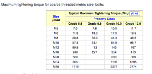

Is all good now or were the lugs stretched too far and I better replace them ?

Even if the bolts are a little stretched they won’t break. Just re-check the torque more regularly for a while and if they’re holding, no worries.

What I'm wondering though is when they were stretched and now torqued to spec, i.e. much lower, whether there's enough friction to keep them on or whether you need to keep the overtorqued value because that's what the metal deformed to. Like whether the metals stays stretched or it is like elastic and forms back into spec dimensions.
They did feel sufficiently tight at correct torque of around 90, so am guessing it's indeed all fine.
