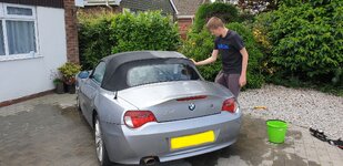

Made a start Saturday morning, with the help off no.1 Son - T he roof, covered in bird kak, slime &God knows what.
Then a quick wash
Looking better already
Then a quick wash
