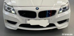

I've been looking for an ideal E89 Z4 for a while. A few I've looked at have an inconsistant panel gap between the front of the bonnet and grille. I was wondering if there is an issue with the cars or they'd been bumped.

This is commonly caused by the bonnet not being closed properly, there’s a latch on each side & they don’t always click down properly unless you press on both sides as the bonnet goes down.

As Rob said above. Easy way to tell is give it a push and it should locate. My other BMW does this all the time as one of the holding clasps gets gummed up. WD40 solves all issues.
Good luck with your search; are you after a particular model?
There are six (could be eight) screws along the top of the bumper (next to where the front of bonnet sits), these are easily adjusted to get the alignment correct.
There are rubber bungs/stops that can be adjusted to fix this.
There may be 4 of these and are quite easy to spot.

It is not closed properly

Also to add to the above , ensure ithe front bumper hasn’t received a bump and broken a plastic bracket and been poorly repaired.its easy to adjust panel gaps on bonnet via rubber twisting bump stops. Bumper is a little more difficult.
