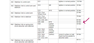

Colb, I think what you've found is the tightening torques for the steering toe link/tie rod.
Here are the ones I found from TIS:

Just added the ball joint specs in on my post, don't think he can over tighten them with a combi spanner they are taper fit so as long as the taper is pulled up its going to be held in solidly and not loosen off.
