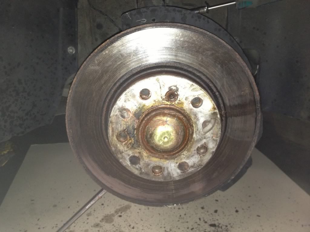

Before

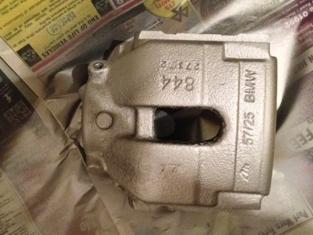

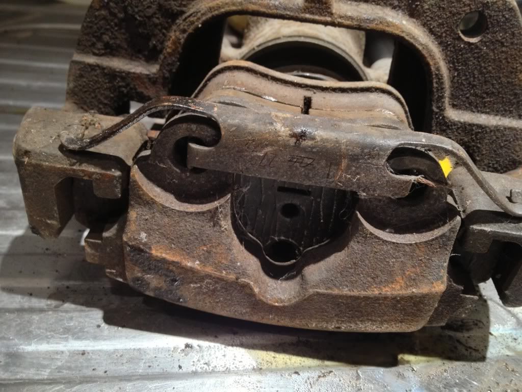

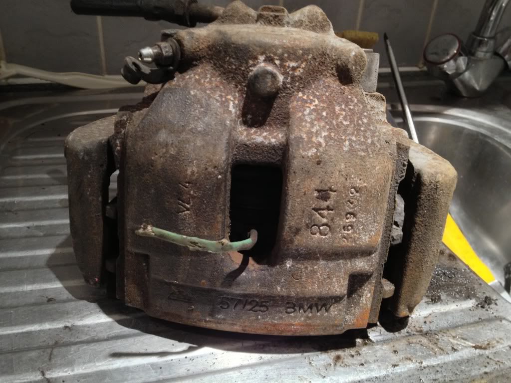

I found a guy on ebay selling a pair of BMW 3.0lt front callipers with carriers and snapped them up for £70. He assured me they where ready to bolt on and had only done 40k miles, i already knew id rebuild them, but when they arrived and sound dead spiders and cobwebs in them so i guessed maybe they had only been on a car that had done 40K but they must have been on a shelf for 2 years, lol!
So i too them apart, wire brushed them down all over, removed the piston and the seals, washed them in Washing up liquid, left them to dry and then sprayed them with silver Halfords calliper paint and left them to dry over night.

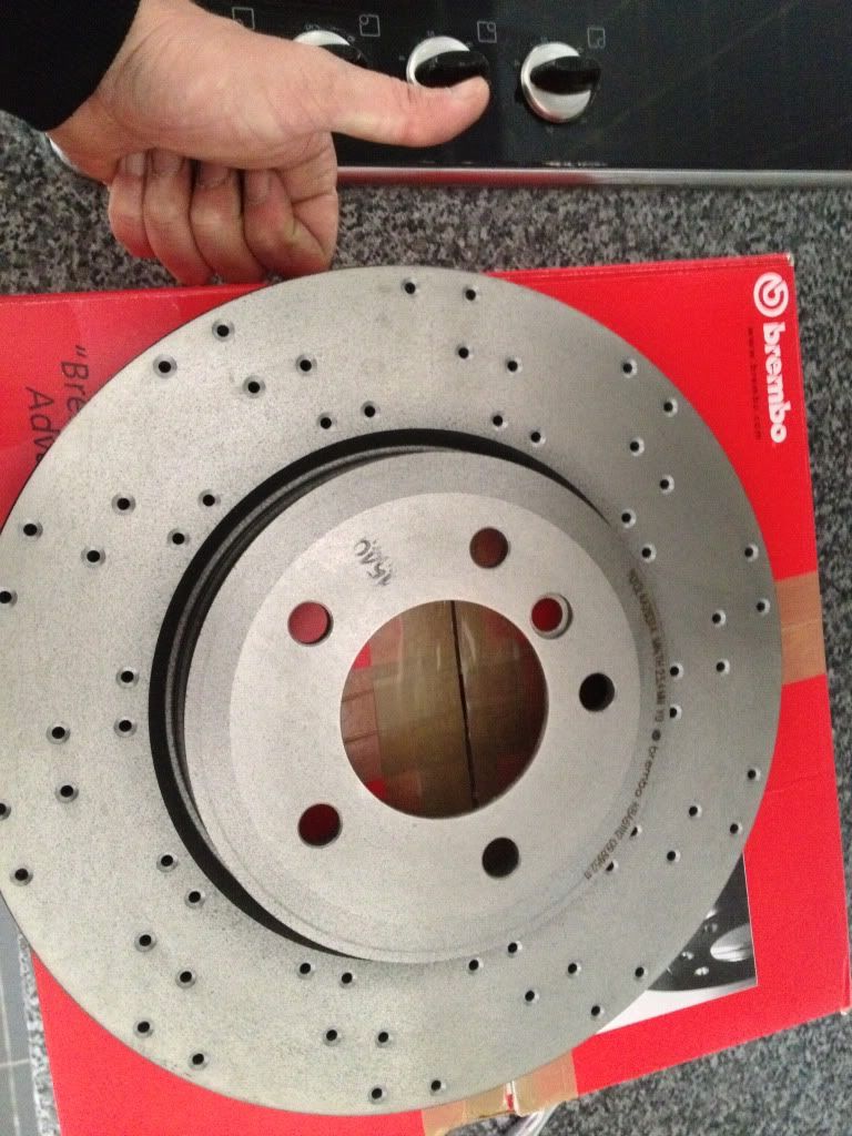

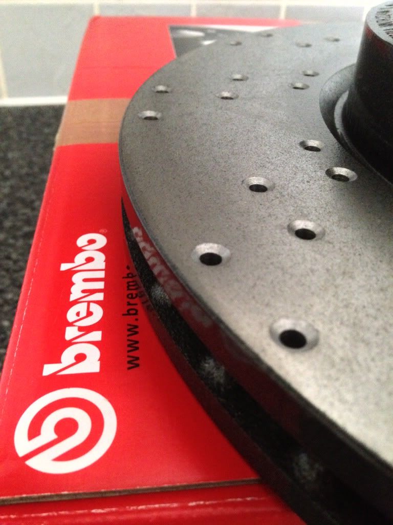

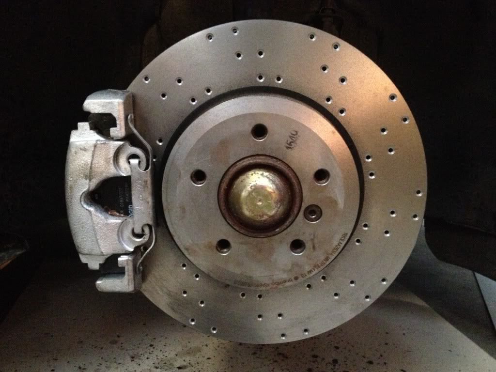

I also found these bad boys on ebay for £100 delivered.

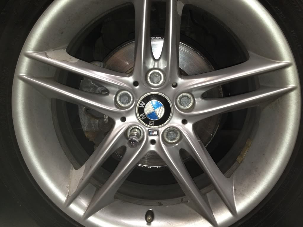

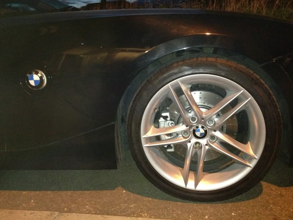

Last night i started removing the drivers side and finished that, and then finished the whole job of this afternoon.
Bosh! Job done, im really chuffed, to me it makes such a big visual difference :)
Excuse the front bumper damage, some C*@t did that in a car park and drove off, thats my next job to sort.
No real noticeable difference really. Still letting them bed in before I deliberately do any emergency stops.

Love the thumbs up picture besides the disk :lol:
I m tempted to get some drilled disks when mine need changing.
That looks really good top job.
I got standard grooved discs and i would recommend drilled over grooved there is a small amount of vibration under long heavy braking. I have checked everything i am guessing its the nature of grooved discs.
