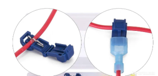

NaweedMustafa said:I switched from the provided scotch locks to T-tap connectors. found this to be quite reliable plus, easy to disconnect in case you want to remove the module for troubleshooting purposes. Just make sure you have a good crimping tool for the Spade connectors which will be attached to the GAPtech wires.
