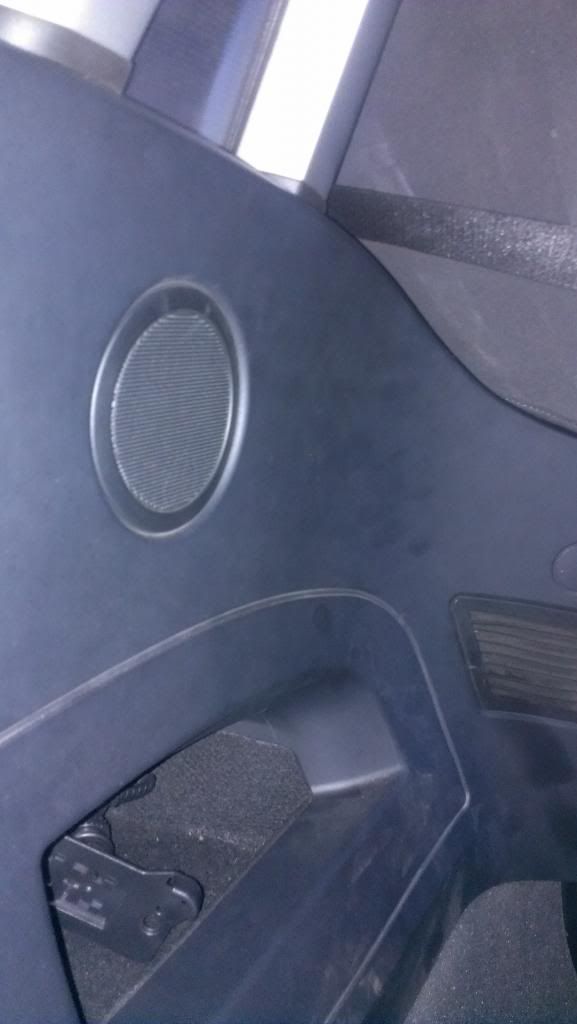

One is a rattle that I just cannot trace exactly hence can't cure, it;s steadily getting worse as time goes on and is now driving me totally insane and actually ruining the experience of driving the car each time. The rattle in question is more a plastic on plastic rubbing sound, a kind of plastic friction culminating in a squeeking noise, and with the suspension being hard is always there unless the road is newly tarmacked :thumbsdown:
The area it is coming from has been traced to the following area as shown in the picture, (the flash on the phone has picked up grease marks,its not actually dirty)
However the exact spoton the panel remains a mystery, I have tried filling out the voids where the two pieces of trim meet, but it has not eased the problem and it appears to be coming from a slightly higher point as shown by the arrow in the next picture
When driving if I pull the passenger seat forward so I can get my arm behind and I grip the trim at the point where the arrow is in the next pic, and pull it towards me the rattle goes, so its deffinatly this trim area that is the problem,though its not that actual point as its where the rubber is inserted
The noise goes when the hood is dropped,I can only assume that it is around the point I have indicated which is then pushed on by the hood in its lowered position,so if anyone has had this same rattle please,please let me know what cured it, or your thoughts!
N.B. Its not the wind deflectors, its not a roll hoop, its not the lowering roof stowage shelf, its not the belt mechaniism, its not the itemin the cubby hole, nor is it anything in the centre console - it is something to do with the trim panel pictured and I believe it to be the area where the arrow is in the 2nd pic....... HELP!!!!!!!! :headbang:

this used to happen to mine. You might try putting the passenger seat forward and tiling the backrest forward. this used to give me room to put my arm across and press areas of the trim that i thought were causing the squeak.
once found, remove trim and stick thin felt on to one of the mating surfaces so that the plastic on plastic situation is removed.
Thats what BMW used to do the teh E85 interior trim to eliminate the incessant squeaking!!

If you remove the little ventilation grill on the right of the first picture you may find a loose wire (I think it's something to do with the roof control module) that bangs against the trim over bumps and resonates. I have a similar annoying rattle and discovered this last week, tucking the wire away removed the associated noise... I've not yet decided on how to secure it properly.
Worth a look as it was driving me mad as well! I thought it was the roll hoops for a long time which shows how deceptive the source can be.

Thats what I mentioned doing in the post,and I have the trim panel thats making the noise and pulling where the arrow is eliminates it,till I let go, however the panel is large and the actual rubbing point could be anywhere (though I think I have narrowed it to the rear area of the panel) hence the post to see if anyone else has had it
Will have to have a look at it and see - Thanks!

Definitely worth checking, if I pulled the trim where your arrows indicated I also stopped the noise as the cable would get trapped rather than free hanging. It's quite a thick cable, like a HDMI cable diameter, hence the noticeable noise as it hits the trim. I was surprised I hadn't read about it being an possible cause when investigating rattles on the forums, I suppose it could be a quirk of my particular car but that would seem odd.

Took it off but cables were tight, moved a few and still there!!
I have further traced the area its coming from to be the panel mentioned and.... the roof mechanism?- when the roof is up and the window up it's horrendous drop the window 5-10mm and its much less evident (but still there slightly) put window up and its back to un-bearable!
Drop the roof and window and it goes completely!
So it would appear its got something to do with the window being up,but since the seal is rubber im further confused!
I wonder if anyone else had found this at all?? or any ideas??? -as I say push on the panel it goes (maybe panel is then pressing on the squeeky part) ????? :headbang: :headbang:
