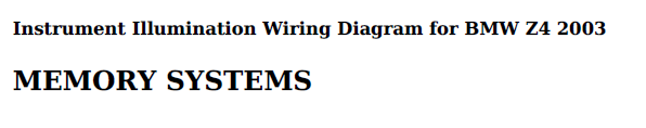

While hunting down a phantom power issue I removed 1 fuse at a time (with car off), measured amps then replaced fuse. When I got to removing F29 the amps dropped by 0.4. I looked up the fuse and it says it is for the driver seat memory module, I don't have power seats so I shouldn't even have this module. However this fuse affected my trunk power trunk release and trunk interior light. Leading me to believe I am using the wrong electrical drawing.
Does anyone know where I can get the correct electrical drawings for my 2003 Z4 E85 manual bare bones car?

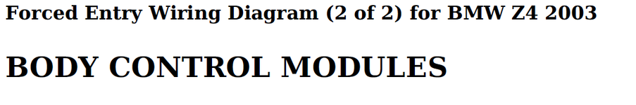

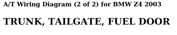

Here are some snips from the electrical manual I currently have:
According to the electrical drawing I have the trunk should be on F11 and F26 (but it is prefaced with "A/T.... automatic?)
F10 and F12 are also shown to have something to do with trunk:
