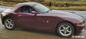

Hopefully picking up a nice little winter Merlot next week to tinker with.
Its got 16" wheels on which might be good for winter boots but it feels like it needs something a little bigger.
Daisys seem to suit the Merlot well so wondered if anyone had a set floating about?
Presentable condition is all I need. With a budget of £200 I dont want to be looking for anything needing immediate refurb.
Any alternatives or suggestions also welcome. :) :driving:
I saw that and thought it’s an interesting looking car
Colour really reminds me of the older E30 burgunrot
Well done! Never seen a hardtop in that colour either!
