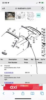

Is there an owner on here of an E89 Z4 that has changed the rubber seal on the window header rail, which seals the roof?
I’d be interesting in knowing whether you encountered any specific difficulties, and of course, if it altered the water coming into the car and the heavy rain conditions.
I know my car is now 12 years old and a few leaks will occur, but I’d like to fix them if I can.
