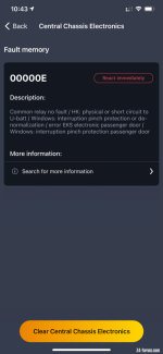

Have tried numerous resets of the trap mech and auto up down as searched on here- no joy
Code scan attached
Now: is my window switch goosed:
Auto down works fine- the two stage switch allows manual down and auto lowering of window
Window up however- no action at all on first pull of switch, and window up behaves as manual on second ‘auto’ function of switch
Thoughts? Anyone had experience of this?

OK, well neither of mine have it, so maybe it is a coding thing?
auto up/down 100% works from passenger switch
Its not on Carly for coding: just looked
Will have a look on INPA

I don’t know what solved it but it’s fixed-
Took the switch apart and (after losing loads of bits) used some contact cleaner
Back together and it all works as it should now!
