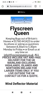

Hi guys I know this has been talked about in the past I have a few pics. My fabric had a few holes in it and after a bit of research I found a company who does flyscreens. They will send out a free sample, it's a great finish.
