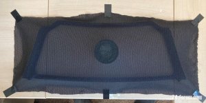

I took the new mesh and cut out a piece about 50mm wider than the deflector frame all round. I then laid the wind deflector frame groove upwards on a desk, placed an upturned small John West tuna/salmon tin (around 40mm tall) in the centre, then laid the mesh over the top. I then used small pieces of duct tape to attach the mesh to the desk - one in each corner, and two in the centre of the long edges:
The trick is to make sure the mesh is lined up (I used the edge of the desk as a guide) and only tight enough to remove any dips and wrinkles.

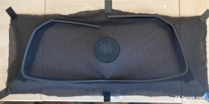

I then started inserting the rubber gasket at the centre of the upper (longer) edge, pushing down gently to the first rib. Try to press straight down and slightly towards the starting point to avoid stretching the gasket as you work your way around. Also do it evenly - press to the first corner, then go back to the centre and press across to the opposite corner.
When you get to the end, you'll probably find that the two ends of the gasket overlap each other, due to the gasket having stretched. Cut one end so that the overlap is only about 1mm, then butt the two ends together and push them into the groove - that way you'll avoid a gap.
Next, undo and remove the duct tape, and remove the tin:
Now continue pressing the gasket down to the next rib - again starting at the centre of the upper edge and working evenly round. If you see any slight stretches or folds in the mesh you can carefully lift up the gasket in that area and correct it.

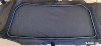

With the gasket fully seated all round, it's time to trim the mesh. I used one of those small knives with blades that can be gradually snapped off as the blade dulls. Insert the blade on the outer edge of the gasket and, holding the mesh tight with the other hand, carefully drag the blade along. Don't press too hard to avoid cutting the gasket itself.
The blade will dull quite quickly, so as soon at you find the mesh difficult to cut, snap off another segment of the blade. Again be careful that the knife doesn't slip - you don't want to scratch the deflector frame, or worse still cover it and the new mesh with your blood!
Hopefully, the end result should look like this:
