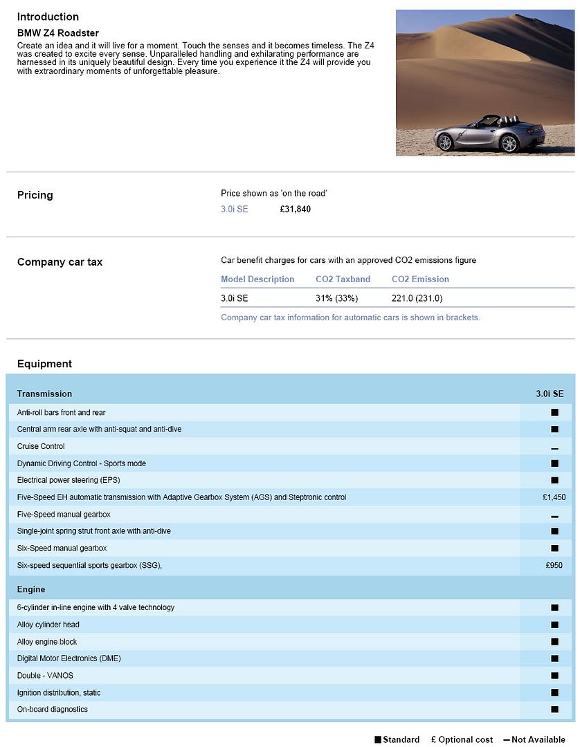

Sorry to hear you're having troubles - the SSG thing is correct - apparently the internal name or something at BMW for this box was SSG - but marketed under SMG - it is the same / proper box you have though.
Sorry can't help with your specific problem - I do know that a weak battery can play tricks on the sensors though - fortunately I've had no such issues with mine - though still only done 32k miles. Good luck !
The early brochures called it SSG as it was called in the E46 330. I think SMG has stuck as a name because of the SMG II in the E46 M3.
