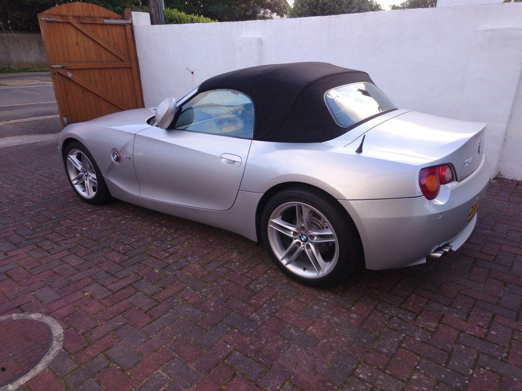

224 wheels off a z4m will fit a 3.0i
I run 224 wheels on my 3.0is 2007 and they fit fine without any rubbing. The only thing to be aware of is don’t run them with the original z4m continental sport tyres as they are slightly larger than the 3.0 tyres in terms of the size of the side wall. Only say this as the size of the 224 wheels is just about on the limit on the rears of what you can fit to a 3.0
Run them on standard 3.0 size tyres and you will be fine.

pvd415uk said:
Hi,
I hope this helps bud.
Is your car lowered ? I ran 224s with M sized rubber on my 06 Si & had no issues at all with catching front or rear :?
zman said:
I just fitted some to my 3.0i today! They fit like a glove and look ace too! :driving: :thumbsup: :
