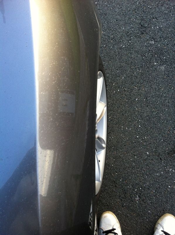

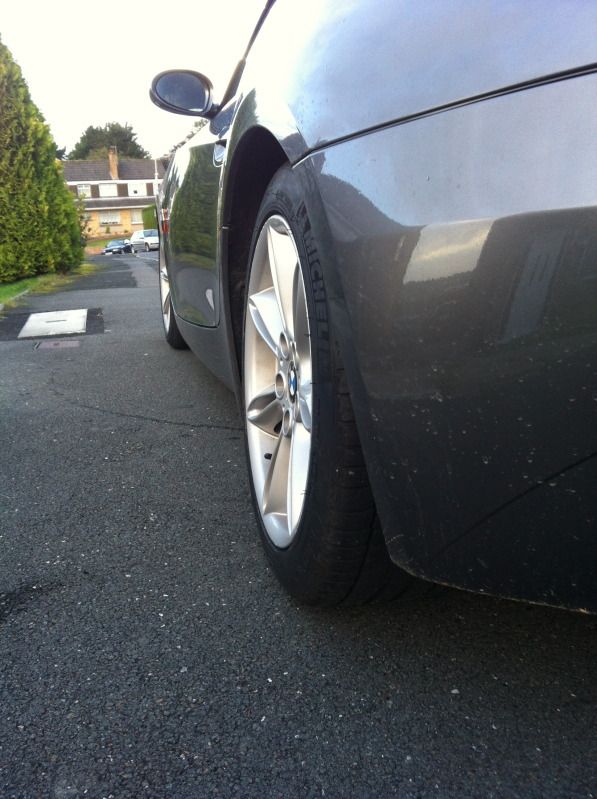

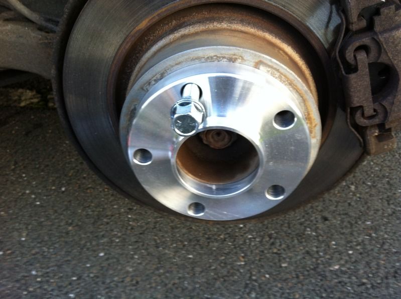

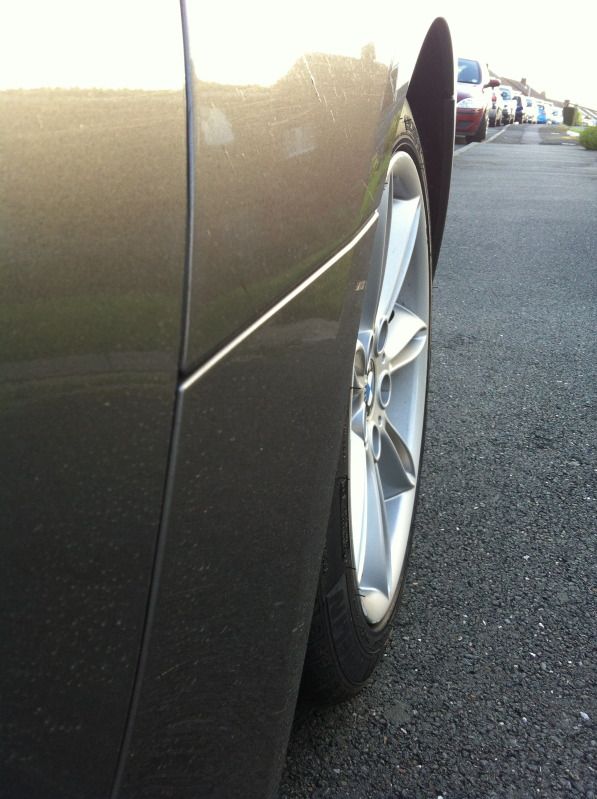

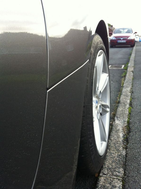

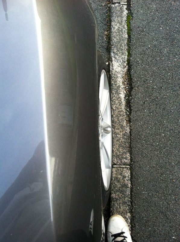

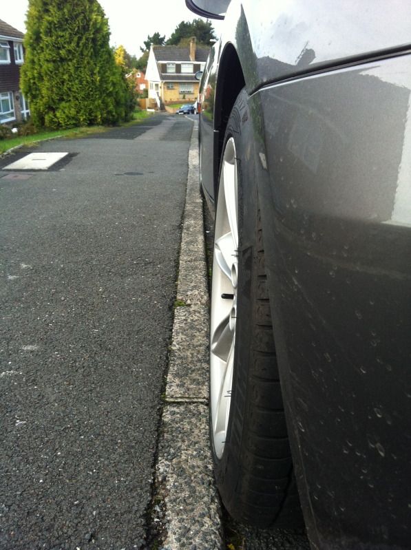

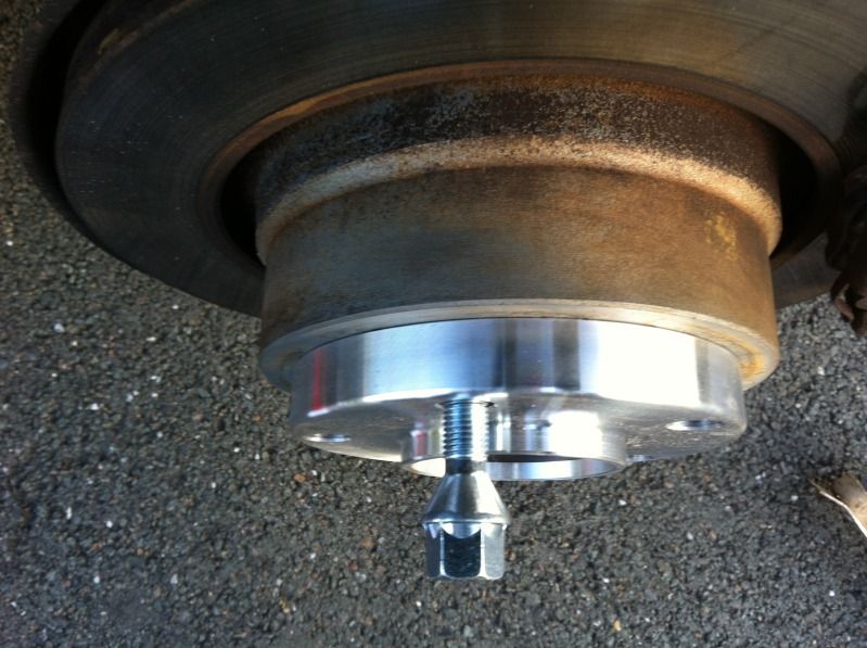

I received some hub-centric 20mm wheel spacers in the post today which I've fitted this morning and i am very pleased with the results. its always bugged me how the rear wheels sit so far back into the arches so i can sleep at night now I've fitted them. i haven't decided if I'm going to fit spacers to the front yet, I'm going to see how these go first. any way heres the pictures before and after. the rear has a much better stance now. probably going to go for a set of lowering springs soon to get the stance right.
before
after
before
after
before
after
a couple pictures of the spacers
