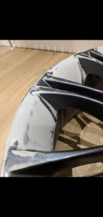

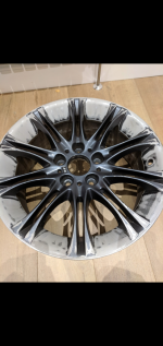

I refurbed an mv2 wheel myself once. It was slow sanding it all by hand but it actually turned out pretty good! Very satisfying in the end.
I didn't get any pictures of the end result unfortunately but this was half way through. If you've got the patience you should do the whole wheel.

Many thanks for sharing..... I will tackle mine over the next week or so😁
You'll need a bit of time, a bit of space and some money for tape and paint/laquer. I needed 1 tin of undercoat, 2 tins of silver and 2 of laquer, and 2 rolls of the blue masking tape. Plus some araldyte if needed to fill, or perhaps it's just a light sanding for you? - if you can get these in bigger quantity then it might be cheaper. Maybe £50 for 4 wheels? Good luck :thumbsup:
